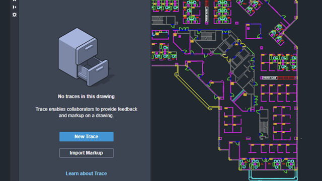

2D Graphics: Below is a list of improvements that have been made to the 2D Graphics system.
- Pan performance is improved for drawings with raster images or wipeouts
- Display performance is improved for trace background, Markup Import and Markup Assist, and ViewCube
- Layout switching performance improvement
