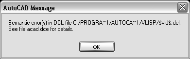

When an error is encountered, one or more dialog boxes alerting you to the error are displayed, or a list of errors are written to a text file named acad.dce. If the error messages are written to acad.dce, it alerts you to this with a message similar to the following:
You can inspect the contents of acad.dce to find the problem. The acad.dce file is placed in the current working directory. When a DCL file is read successfully, the acad.dce file is deleted.
