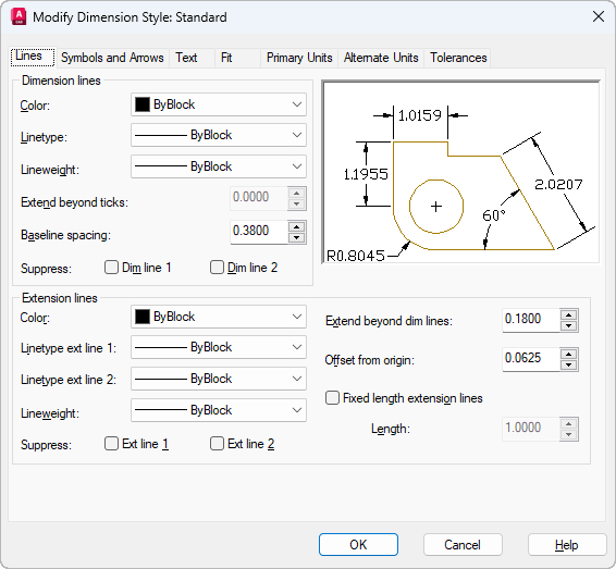

Sets the format and properties for dimension lines, extension lines, arrowheads, and center marks.
DIMSTYLE (Command) Find:
Sets the dimension line properties.
List of Options
The following options are displayed.
Dimension Lines
- Color
Displays and sets the color for the dimension line. If you click Select Color (at the bottom of the Color list), the Select Color dialog box is displayed. You can also enter a color name or number. (DIMCLRD system variable)
You can select colors from the 255 AutoCAD Color Index (ACI) colors, true colors, and Color Book colors.
- Linetype
Sets the linetype of the dimension line. (DIMLTYPE system variable)
- Lineweight
Sets the lineweight of the dimension line. (DIMLWD system variable)
- Extend Beyond Ticks
Specifies a distance to extend the dimension line past the extension line when you use oblique, architectural, tick, integral, and no marks for arrowheads. (DIMDLE system variable)
- Baseline Spacing
Sets the spacing between the dimension lines of a baseline dimension. Enter a distance. For information about baseline dimensions, see DIMBASELINE. (DIMDLI system variable)
- Suppress
Suppresses display of dimension lines. Dim Line 1 suppresses the first dimension line; Dim Line 2 suppresses the second dimension line. (DIMSD1 and DIMSD2 system variables)
Extension Lines
Controls the appearance of the extension lines.
- Color
Sets the color for the extension line. If you click Select Color (at the bottom of the Color list), the Select Color dialog box is displayed. You can also enter a color name or number. (DIMCLRE system variable.)
- Linetype Ext Line 1
Sets the linetype of the first extension line. (DIMLTEX1 system variable)
- Linetype Ext Line 2
Sets the linetype of the second extension line. (DIMLTEX2 system variable)
- Lineweight
Sets the lineweight of the extension line. (DIMLWE system variable)
- Suppress
Suppresses the display of extension lines. Ext Line 1 suppresses the first extension line; Ext Line 2 suppresses the second extension line. (DIMSE1 and DIMSE2 system variables)
- Extend Beyond Dim Lines
Specifies a distance to extend the extension lines above the dimension line. (DIMEXE system variable)
- Offset From Origin
Sets the distance to offset the extension lines from the points on the drawing that define the dimension. (DIMEXO system variable)
- Fixed Length Extension Lines
Enables fixed length extension lines. (DIMFXLON system variable)
- Length
Sets the total length of the extension lines starting from the dimension line toward the dimension origin. (DIMFXL system variable)
Preview
Displays sample dimension images that show the effects of changes you make to dimension style settings.
