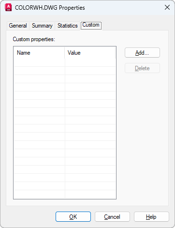

Custom Tab (Drawing Properties Dialog Box)
Assigns custom properties to the drawing.
Summary
For example, you could create a custom property called Project and assign the actual project name as the value. To assign the same custom properties to a group of drawings, create the custom properties in a drawing template file.
Custom properties are displayed in the list of field names in the Field dialog box. You also have access to the properties data using programming interfaces, such as AutoLISP®.
List of Options
The following options are displayed.
Custom Properties
Lists names and values of custom properties for the current drawing.
Add
Displays the Add Custom Property dialog box, where you can enter a name and a value for the new custom property. The name must be unique. The value can be left blank.
Delete
Deletes the custom property that is selected in the list.
Note: If you delete a custom property that is used in a field, the field displays #### the next time it is updated.
