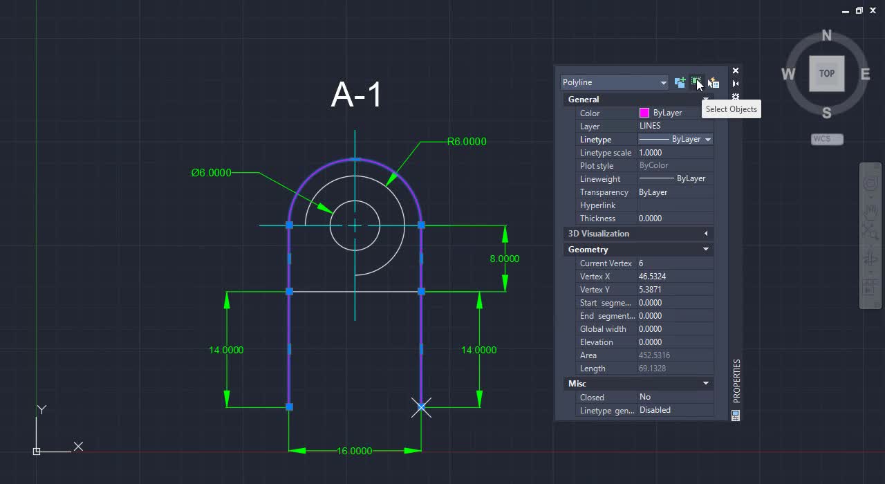

  7. Let's try a different object. Select the polyline.
    Notice that the properties available for the polyline are different from those of the center mark.
  8. Polylines consist of one or more line or arc segments. A vertex defines the start and endpoint of a segment. The order of the vertices follows how the polyline was created.
    Let's say you want to stretch the individual segments of the polyline.
  9. To adjust the first vertex, in the Properties palette, under Geometry, click the Current Vertex box.
    An X marker indicates the vertex of the polyline that you're editing. You can only edit one vertex at a time.
  10. From the Current Vertex property, select 1.
  11. Change the Vertex X/Y values and see what happens. In this example, I changed the Vertex Y value (from 31.0023 to 25.0023) to move the first vertex vertically downward.
    Note: The dimension automatically updates when the vertex is changed.
  12. Select another vertex by clicking the arrows of the spinner next to the Current Vertex value. In this example, I chose the last vertex and specified the same Vertex Y value as the first vertex.
    Now, the first and last vertices of the polyline are aligned. This method of editing the vertices is useful when you know the absolute coordinates you want.
