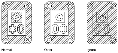

The three island detection styles are compared below:

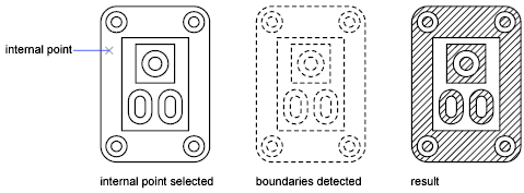

Using Normal island detection, if you specify the internal pick point shown, islands remain unhatched and islands within islands are hatched.
Using the same pick point, the results of the options are compared below.
Set the system variable HPISLANDDETECTION as follows:
  • 0=Normal
  • 1=Outer
  • 2=Ignore
