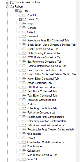

Display a Ribbon Tab on the Ribbon
  1. In the Customize tab, Customizations In <file name> pane, click the plus sign (+) next to the Workspaces node to expand it.
  2. Select the workspace that you want to modify.
  3. In the Workspace Contents pane, click Customize Workspace.
  4. In the Customizations In <file name> pane, click the plus sign (+) next to the Ribbon Tabs node to expand it.
  5. Click the check box next to each ribbon tab that you want to add to the workspace.
  6. In the Workspace Contents pane, click Done.
    Note: Make sure to set the workspace current to see the changes.
  7. Click Apply.

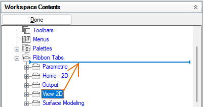

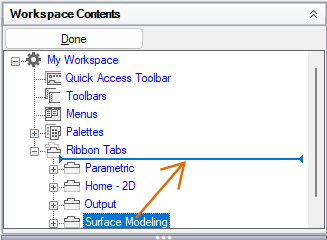

Reposition a Ribbon tab on the Ribbon
  2. Select the workspace that has the ribbon tab you want to reposition.
  3. In the Workspace Contents pane, click the plus sign (+) next to the Ribbon Tabs node to expand it.
  4. Drag the ribbon tab to the new location.
    A horizontal bar shows the new location for the ribbon tab.
  5. Once the horizontal bar is in the place where you want to insert the ribbon tab, release the pointing device button.
  6. Click Apply.

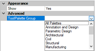

Associate a Tool Palette Group with a Ribbon tab
  1. At the Command prompt, enter toolpalettes.
  2. Click Manage tab Customization panel User Interface. Find
  3. In the Customize tab, Customizations In <file name> pane, click the plus sign (+) next to the Workspaces node to expand it.
  4. Select the workspace that has the ribbon tab for which you want to assign a tool palette group.
  5. In the Workspace Contents pane, click the plus sign (+) next to the Ribbon Tabs node to expand it.
  6. Select the ribbon tab that you want to assign a tool palette group.
  7. In the Properties pane, under Advanced, ToolPalette Group box, click the drop-down list and select the tool palette group you want to assign to the ribbon tab.
    Note: The Tool Palettes window must be displayed before you can assign a tool palette group to a ribbon tab.
  8. Click Apply.

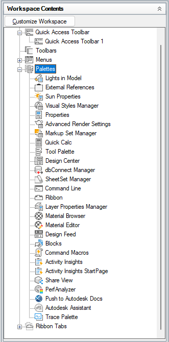

Display a Palette
  3. In the Workspace Contents pane, click the plus sign (+) next to the Palettes node to expand it.
  4. Select the palette you want to display.
  5. In the Properties pane, under Appearance, Show box, click the drop-down list and select Show.
  6. Click Apply.

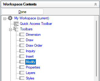

Display Toolbars
  4. In the Customizations In <file name> pane, click the plus sign (+) next to the Toolbars node to expand it.
  5. Click the check box next to each toolbar that you want to add to the workspace.
  7. Click Apply.
