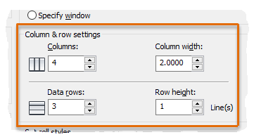

- In the Insert Table dialog box, enter 4 columns and 3 data rows. Specify a location for the table.

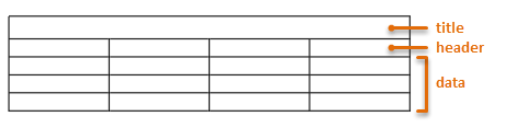

By default, there are three styles of cells that appear when you use the Standard table style:

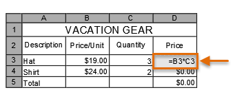

- Enter the values in each cell as shown below.
If you assigned the data format as Currency, the $ symbol will appear automatically. The $0.00 entries are needed as placeholders for the format. If the values for the currency columns don't display the $ symbol, right click and then choose Data Format to change the cell data format to Currency.
- In the first cell under Price (D3), enter
=B3*C3. The cells are automatically multiplied.
- Similarly, in cell D4, enter =B4*C4.
- Next, in cell D5 enter
=SUM(D3:D4).
The colon between D3 and D4 indicates a range of cells between D3 and D4 inclusive.
