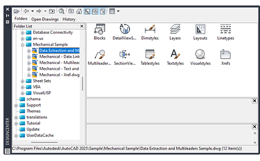

The DesignCenter Window
Use the tree view on the left to browse sources of content and to display content in the content area on the right. From the content area, you can add items to a drawing or to a tool palette. A preview or description is displayed for selected drawings, blocks, hatch patterns, or xrefs.
The DesignCenter toolbar controls navigation and display of information in the tree view and the content area. The same navigation and display options are available on the shortcut menu. Right-click in the content area to display the menu.
As with other dockable windows and palettes, you can resize, dock, and anchor DesignCenter. Many of these options can be set selecting an option on the shortcut menu.
