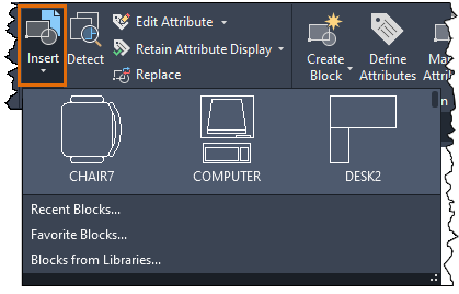

From the Home tab, Blocks panel, click Insert to display a gallery of blocks in the current drawing without opening the Blocks palette. The other two options, Recent Blocks and Blocks from Libraries, open the Blocks palette to the corresponding tab.
