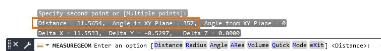

Share Email Facebook Twitter LinkedIn To Find the Distance and Angle Between Two Points Click Home tab Utilities panel Measure drop-down Distance. Find Specify a first and a second point. Use object snaps for precision. The measurements are shown in the command window. If necessary, press F2 to expand the command window. Related Concepts About Finding Distances, Angles, and Point Locations Related Reference Commands for Distances and Angles
