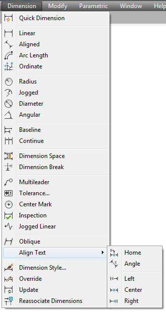

In the following example menu, the Align Text menu item has been inserted into the Dimension menu at the 17th index. The Align Text menu item is of the type acSubmenu. All other menu entries in the example are of the type acMenuItem or acMenuSeparator. The small cascading menu that is displayed when Align Text is selected is the new menu that was returned by the AddSubmenu method. It has been populated using the AddMenuItem and AddSeparator methods.
