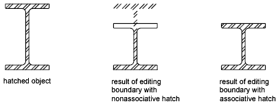

Hatch Boundaries and Associativity
In the following illustration, the concrete hatches are bounded, while the earth hatches are unbounded.
By default, bounded hatches are associative, which means that the hatch object is associated with the hatch boundary objects: changes to the boundary objects are automatically applied to the hatch.
Nonassociative hatches are not updated when their original boundary is changed.
Hatch associativity is turned on by default and is controlled by the HPASSOC system variable. You can change hatch associativity using the Associate button on the Options palette, the Properties palette, or the Hatch Edit dialog box.
