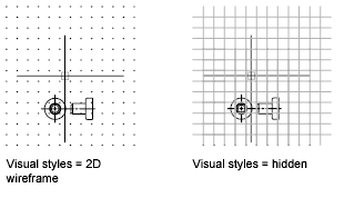

Control the Display Style and Area of the Grid
You can change the display style of the grid with several options in the Snap and Grid tab of the Drafting Settings dialog box. For example, the grid displays as a rectangular pattern of lines by default, but you can change it to the legacy dotted grid style when the visual style is set to 2D wireframe.

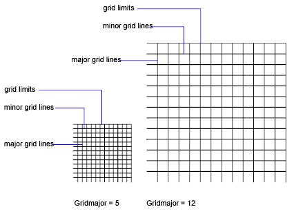

Another display option controls the area covered by the grid. You can limit the extents of the grid to a rectangular area rather than the entire XY plane of the UCS. This option is useful if you need to focus your work on a portion of the drawing area.
Control the Frequency of Major Grid Lines
If the grid is displayed as lines rather than dots, darker lines called major grid lines display at intervals. When working in decimal units or with feet and inches, major grid lines are especially useful for measuring distances quickly. You can control the frequency of major grid lines in the Drafting Settings dialog box.
To turn off the display of major grid lines, set the frequency of major grid lines to 1.

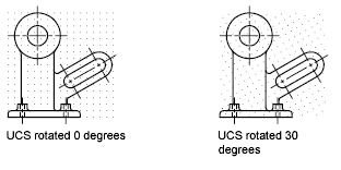

Change the Grid and Snap Angle and Base
If you need to draw along a specific alignment or angle, you can change the grid and snap angle by rotating the user coordinate system (UCS). This rotation realigns the crosshairs on the screen to match the new angle. In the following example, the UCS is rotated 30 degrees to match the angle of the anchor bracket.
The grid and snap points are always aligned with the UCS origin. If you need to shift the grid and grid snap origin, move the UCS.
