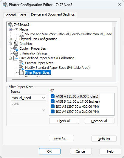

Device and Document Settings Tab (Plotter Configuration Editor)
Controls many of the settings in the plotter configuration (PC3) file.
PLOTTERMANAGER (Command) Find: Double-click a PC3 file
Click the icon for any of the nodes to view and change its settings.

Filter Paper Sizes
Filters the list of paper sizes displayed for the plotting device selected in the Plot and Page Setup dialog boxes. The list of paper sizes is displayed on the Plot Settings tab in the Plot dialog box and on the Layout Settings tab in the Page Setup dialog box.
Select the paper sizes you want to display for this device.
  • Check All: Hides all the paper sizes for the device.
  • Uncheck All: Displays all the paper sizes for the device.
