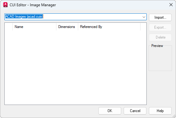

Image Manager Dialog Box (CUI)
Manages the images that are in the selected customization file.
CUI (Command) Find: Image Manager
List of Options
The following options are displayed.
Loaded Customization Files List
Lists the customization files that are currently loaded.
Custom Images List
Lists the images that are stored in the customization file selected from the Loaded Customization Files list.
Import
Imports an externally stored image into the selected customization file from the Loaded Customization Files list.
Export
Exports the selected custom images from the Custom Images list to an external local or network storage location.
Delete
Permanently deletes the selected image from the Custom Images list and the customization file.
Preview
Displays a preview of the selected image in the Custom Images list.
