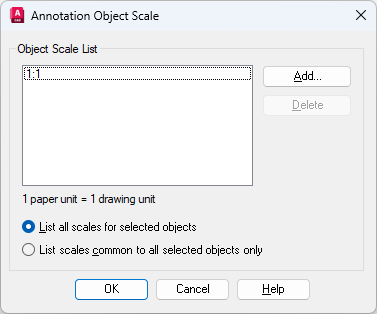

Adds or deletes supported scales for the selected annotative object.
OBJECTSCALE (Command) Find
List of Options
The following options are displayed.
- Object Scale List
Displays the list of scales supported by the selected object.
- List all scales for selected objects
Specifies that all scales supported by the selected objects are displayed in the Object Scale List.
- List scales common to all selected objects only
Specifies that only the supported scales that are common to all selected objects are displayed in the Object Scale List.
- Add
Displays the Add Scales to Object Dialog Box.
- Delete
Removes the selected scale from the scale list.
Note: The current scale or scales referenced by objects or views cannot be deleted.
