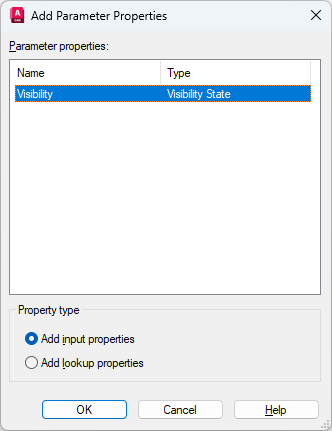

Add Parameter Properties Dialog Box
Adds parameter properties to a lookup table.
BLOOKUPTABLE (Command): Add Properties
List of Options
The following options are displayed.
Displays a list of parameters not yet added to the lookup table. Select a parameter and click OK to add it to the lookup table.
Property Type
Specifies the type of property to add to the lookup table.
Add Input Properties
Displays the available custom properties in parameters you’ve already added to the block definition.
Add Lookup Properties
Displays the available lookup property parameters that can be added to the lookup table.
