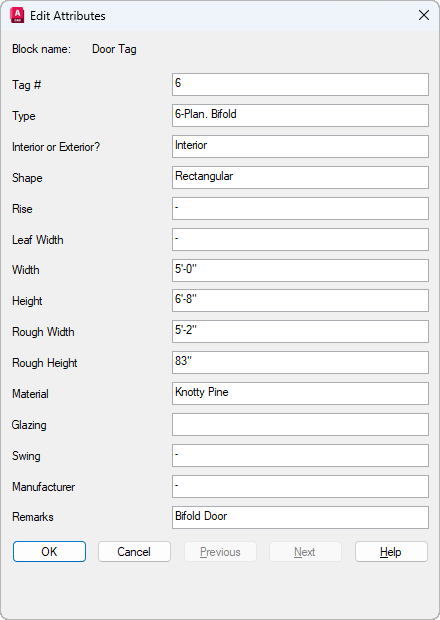

ATTEDIT (Command) Find
This dialog box changes the values of specific block attributes. To change attribute properties such as position, height, and style, use -ATTEDIT.
List of Options
The following options are displayed.
- Block Name
Indicates the name of the selected block. The value of each attribute contained in the block is displayed in this dialog box.
- List of Attributes
Displays the first 15 attributes contained in the block. You can edit the attribute values. You cannot edit attribute values on locked layers.
Multiple-line attributes display the In-Place Text Editor with the Text Formatting toolbar and the ruler. Depending on the setting of the ATTIPE system variable, the Text Formatting toolbar displayed is either the abbreviated version, or the full version.
To use a field as the value, right-click and click Insert Field on the shortcut menu to display the Field dialog box.
- Previous
Displays the previous eight attribute values, if any.
- Next
Displays the next eight attribute values, if any.
