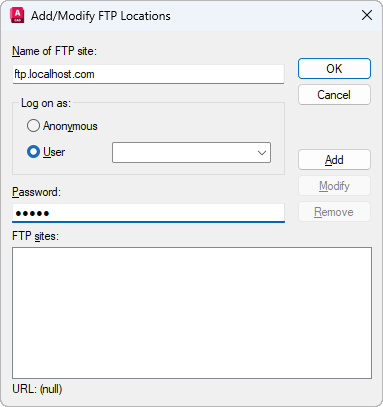

Add/Modify FTP Locations Dialog Box
Defines the FTP sites that you can browse within standard file selection dialog boxes.
OPEN (Command) Find
To browse the sites that you add, select FTP from the Places list in the standard file selection dialog box.
To access the Add/Modify FTP Locations dialog box, in a standard file selection dialog box, choose Tools Add/Modify FTP Locations.
List of Options
The following options are displayed.
Name of FTP Site
Specifies the site name for the FTP location (for example, ftp.autodesk.com).
Log On As
Specifies whether to log on to the FTP site anonymously or with a specific user name.
Anonymous
Logs you on to the FTP site as an anonymous user. If the FTP site does not allow anonymous logons, select User and enter a valid user name.
User
Logs you on to the FTP site using the specified user name.
Password
Specifies the password to use to log on to the FTP site.
Add
Adds a new FTP site to the list of FTP locations available from the standard file selection dialog box.
Modify
Modifies the selected FTP site to use the specified site name, logon name, and password.
Remove
Removes the selected FTP site from the list of FTP locations available from the standard file selection dialog box.
FTP Sites
Lists the FTP sites that are available from the Places list in all standard file selection dialog boxes.
URL
Displays the URL for the selected FTP site.
