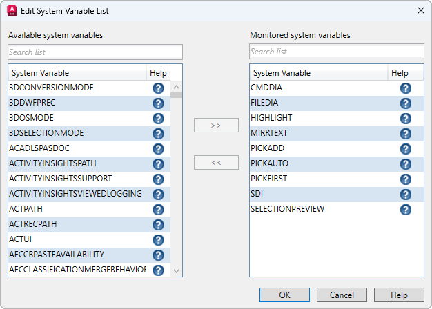

Edit System Variable List Dialog Box
Manages the monitored system variables list.
SYSVARMONITOR (Command): Edit List
You can select or search for a system variable to be added or removed from the monitored system variables list.
Note: Read-only system variables are excluded in the list.
The following options are displayed.
Available System Variables
Lists all available system variables that can be monitored. Enter a string on the search box to quickly find a system variable.
Monitored System Variables
Lists all system variables that are being monitored. Enter a string on the search box to quickly find a system variable.
