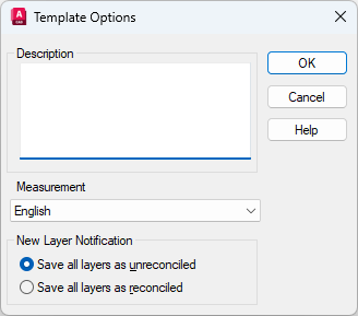

The Template Options dialog box displays automatically after you specify the files of type as *.dwt, enter the template file name, and click Save.
List of Options
The following options are displayed.
Description
Specifies a description for the drawing template. This description is displayed when you choose the template in the Startup dialog box or in the Create New Drawing dialog box.
Measurement
Specifies whether the drawing template uses English (imperial) or metric units.
New Layer Notification
Save All Layers As Unreconciled
Saves the template file with its layers set as unreconciled, which means that a layer baseline is not created.
See Reconcile New Layers for more information about unreconciled layers.
Save All Layers As Reconciled
Saves the template file with its layers set as reconciled, which results in creating a layer baseline.
