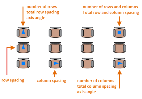

With associative arrays, you can perform edits directly using grips, with grip menu options that appear when you hover over a grip, or by using the ARRAYEDIT command from the contextual tab or at the Command prompt. For example, here are the primary controls for a rectangular array of chairs. Path arrays and polar arrays have similar controls.
After an associative array is created, you can still modify the items in the array as follows:
  • Edit a source item of the array. All instances of the source item will be updated automatically.
  • Remove one or more items in the array.
  • Replace one or more items in the array with selected objects. You can also add or delete objects associated with the array item.
In the example, the first column of display tables was replaced by a shorter version, and two of the tables in the top row were deleted.
Even after these changes, the array remains associative, and the spacing and angles between the items can still be changed dynamically in a single operation.
