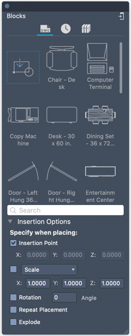

Toolbar
  • Displays the blocks in the current drawing.
  • Displays recently inserted or created blocks. The recent list persists across drawings and sessions.
    Note: The name of an external file that's inserted as a block includes an asterisk (*) in the Blocks palette.

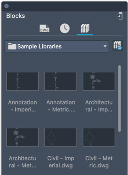

  • Displays the blocks from a block library. Click browse to specify a drawing file or folder.
Block Libraries Navigation
  • Specify a cloud storage file or folder that contains the blocks. Use this method to share blocks across devices. A block library located on the cloud is indicated on the palette.
  • Double-click a subfolder to display the contents of that folder.
  • Click Back to Library to return to the previous drawing or folder.
  • Select Sample Libraries from the drop-down menu to access the legacy block libraries.
Blocks List
Displays the blocks for the selected category. To insert a block do one of the following:
  • Drag and drop a block from the list
  • Double-click on a block thumbnail
  • Right-click on a block thumbnail and select Insert in Drawing

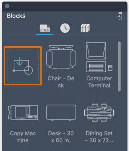

  • Click the block icon from the current drawing view to browse to any DWG file to insert

Insertion Options
Insertion Point
Specifies the insertion point for the block. When checked, you specify the insertion point when inserting the block, using either your pointing device or manually entering coordinates. When cleared, specified coordinates are used.
Note: Does not apply when you drag to place a block.
Scale
Specifies the scale for the inserted block. When checked, you specify the scale factors in the X, Y, and Z directions. If you enter a negative value for the X, Y, and Z scale factors, the block is inserted as mirror image around that axis. When cleared, specified scales are used.
Note: When checked, the last entered values are used when you drag to insert a block. You are not prompted for the scale.
Rotation
Specifies the rotation angle for the inserted block in the current UCS. When checked, you specify the rotation angle of the block using the pointing device or entering an angle. When cleared, the specified rotation angle is used.
Note: When checked, the last entered values are used when you drag to insert a block. You are not prompted for the rotation.
Repeat Placement
Controls whether the block insertion automatically repeats. When checked, you will be prompted automatically for additional insertion points until you press Esc to cancel the command. When cleared, the block you specified is inserted once.
Explode
Controls whether the block is automatically exploded into its component objects when inserted.
When checked, the component objects in the block are disassociated and revert to their original properties. As an indication that the block will be exploded on insertion, the preview of the block at the cursor is automatically suppressed. Objects using the BYBLOCK color are white. Objects with BYBLOCK linetype use the CONTINUOUS linetype.
When this option is cleared, the specified block is inserted without being exploded.
Note: You can specify this option with a uniform scale factor only. If you need to explode a non-uniformly scaled block, you can still do so manually with the EXPLODE command.
