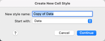

Create New Cell Style Dialog Box
Specifies a name for the new cell style and specifies the existing cell style on which the new cell style will be based.

New Style Name
Names the new cell style.
Start With
Specifies an existing cell style whose settings are the default for the new cell style.
Continue
Returns you to the New or Modify Table Style dialog box, in which you define the new cell style.
