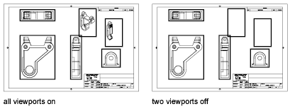

You can save time by turning some layout viewports off or by limiting the number of active viewports.
Displaying a large number of active layout viewports can affect your system's performance as the content of each layout viewport regenerates. You can save time by turning some layout viewports off or by limiting the number of active viewports. The following illustration shows the effects of turning off two layout viewports.
New layout viewports are turned on by default. If you turn off the layout viewports you aren't using, you can copy layout viewports without waiting for each one to regenerate.
If you don't want to plot a layout viewport, you can turn the layout viewport off.
