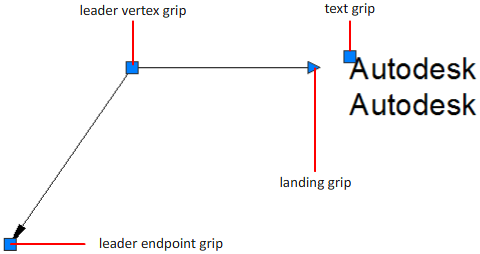

You can make many leader edits directly using multi-functional grips. You can add and remove leaders, add and remove vertices, lengthen or move the landing line, or move the leader text.
Hover over a grip to access the option you want.
  • From the Landing grip, you can choose:
    • Stretch to move the leader landing.
    • Lengthen Landing to extend the Landing line.
    • Add Leader to add one or more leader lines.
  • From a leader endpoint grip, you can choose:
    • Stretch to move the leader endpoint.
    • Add Vertex to add a vertex to the leader line.
    • Remove Leader to delete the selected leader line.
  • From a leader vertex grip, you can choose:
    • Stretch to move the vertex.
    • Add Vertex to add a vertex on the leader line.
    • Remove Vertex to delete the vertex.
