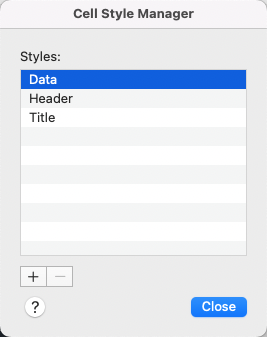

Cell Style Manager Dialog Box
Displays all cell styles within the current table style and allows you to create or delete a cell style.

Styles
Lists all cell styles contained within the current table style. The cell styles Title, Header, and Data are always contained within any table style.
New
Displays the Create New Cell Style dialog box. From here, you can create a new cell style to be contained within the current table style.
Delete
Allows you to delete the selected cell style.
Rename
Right click a cell style name to give a new name to the selected cell style. The Title, Header, and Data cell styles cannot be renamed.
