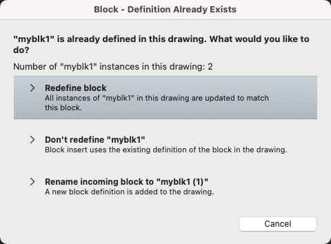

    The dialog box displays.
  6. Click Redefine Block.
  7. Insert an instance of the block. All instances of the block on the current drawing update.

  6. In the dialog box, click Redefine Block.
