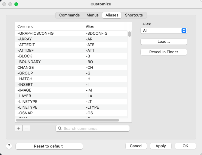

Manages the available command aliases. A command alias is an abbreviation of a command name, which you can enter at the Command prompt instead of entering the entire command name.
CUI (Command)
Menu: Tools > Customize > Interface (CUI).
The following options are displayed.
Command\Alias List
Displays the current list of command aliases. Click a column header to sort the list by that column.
Add
Displays the visor where you can assign an alias to a command.
Remove
Removes the selected aliases.
Search
Enter text to filter the list of commands that have an assigned alias.
Alias drop-down
You can view all command aliases or you can view just the custom aliases.
Load
Browse to and load an existing PGP file to import command aliases.
Reveal in Finder
Locates the acaduser.pgp file in Finder. This is helpful if you want to copy the file to another machine.
Apply
Save and apply the changes made so far in the dialog box.
Note: Custom aliases are stored in the acaduser.pgp file. Program defined aliases are stored in the acad.pgp file. It is not recommended that you edit the acad.pgp file directly.
