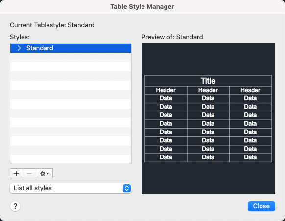

Creates and modifies table styles, which control the appearance of tables.
Access Methods
TABLESTYLE (Command)
Tool Sets: Drafting tab > Table panel > Table Style.
Menu: Format > Table Style.
List of Options
The following options are displayed.
Current Table Style
Displays the name of the table style that is applied to tables you create. Right-click a table style name and select Set Current to change the current table style.
Styles
Displays a list of table styles. The current style is highlighted.
Preview Of
Displays a preview image of the style that is selected in the Styles list.
Set Current
Sets the table style selected in the Styles list as the current style. All new tables are created using this table style.
New
Coming soon: Displays the Create New Table Style dialog box, in which you can define new table styles.
Delete
Deletes the table style selected in the Styles list. A style that is being used in the drawing cannot be deleted.
Options
Displays the Modify Table Style dialog box, in which you can modify table styles.
