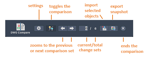

The DWG Compare visor opens and the comparison results display in the current drawing. This visor provides several commands and options to review and control the comparison result.

- Click Settings on the DWG Compare visor.
- In the Settings panel, click the controls that you want to change.

Click to hide the comparison results temporarily as you work in the current drawing.
Navigate Between Change Sets
Click the right and left arrows to zoom in to the next or previous change set.
Copy Objects From the Compared Drawing to the Current Drawing
Click Import Objects to import selected objects from the compared drawing into the current drawing.
- Select the objects in the comparison that you want to copy into the current drawing and press Enter. Only those objects that are not in the current drawing can be imported.

Export a Snapshot Drawing to Save the Differences
Click Export Snapshot to combine the two comparison drawings into a new snapshot drawing file for further review.

End the Comparison
Click to end the comparison and close the DWG Compare visor.
