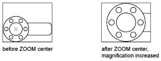

- Center
Zooms to display a view defined by a center point and a magnification value or a height. A smaller value for the height increases the magnification. A larger value decreases the magnification. Not available in perspective projection.

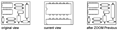

- Previous
Zooms to display the previous view. You can restore up to 10 previous views.
