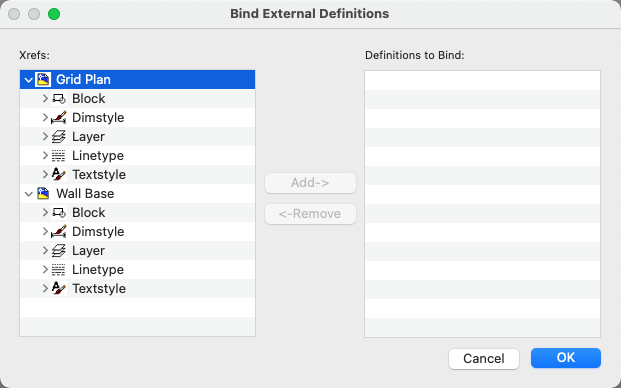

Adds xref-dependent named objects (such as blocks, dimension styles, layers, linetypes, and text styles) to your drawing.
XBIND (Command)
Menu: .
List of Options
The following options are displayed.
- Xrefs
Lists the xrefs currently attached to the drawing. Selecting an xref (double-clicking) displays the named object definitions in the attached xref.
- Definitions to Bind
Lists the xref-dependent named object definitions to bind to the host drawing.
- Add
Moves the named object definitions selected in the Xrefs list into the Definitions to Bind list.
- Remove
Moves the xref-dependent named object definition selected in the Definitions to Bind list back to its xref-dependent definition table.
