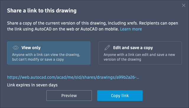

Shares a link to a copy of the current drawing to view or edit in the AutoCAD web app. The drawing copy includes all external references and images.
Access Methods
Toolbar:
Menu: File > Share
Anyone with the link can access the drawing in the AutoCAD web app. The link expires seven days after it's created. You can choose between two permission levels for recipients: View only and Edit and save a copy.
