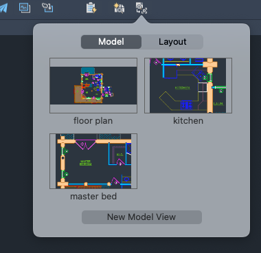

Model Tab
If a layout is active, selecting a named view that was saved in model space places a viewport on to the current layout. Click Insert New Model View to create a view and insert it on the active layout.
If model space is active, selecting any named view switches to that view. Click New Model View to create a view and add it to the view gallery.

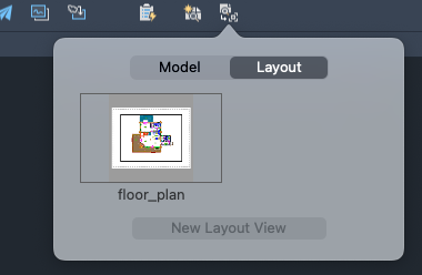

Layout Tab
Selecting any view created from a layout, switches to that view. Click New Layout View to create a layout view and save it to the gallery.
