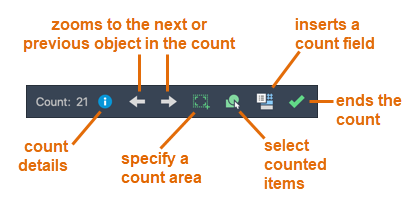

When you're in an active count, the Count visor displays at the top of the drawing area. The Count visor includes the number of objects and issues, along with other controls to manage the counted objects.
The count details icon changes depending on whether the current count contains errors. Click or to open the Count palette and view more details.

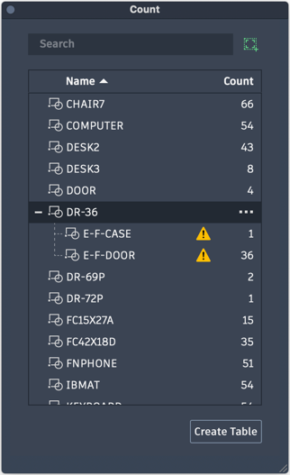

Displays the count criteria including the general properties of the counted objects and any user-defined block attributes and parameters.
Displays the count criteria including the general properties, user-defined block attributes and parameters, and the issue report of the counted objects. Issues can include overlapping, exploded, or renamed objects.
Note: The count list includes blocks that are nested within other blocks.
Count all blocks
  1. Select Count from the toolbar.
  2. Enter E for the entire model space, then press Enter to list all blocks.
    The Count palette displays the number of instances of each block on the drawing.
  3. Click a block name on the palette to highlight all instances of that block in the drawing.
