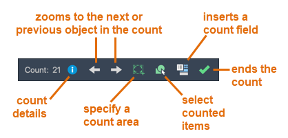

Visor Commands and Options
When you're in an active count, the Count visor displays at the top of the drawing area.
The following controls are available.
Count
Displays the count of the selected object.
Count Details
Displays the count information of the selected object. The count details icon changes depending on whether the current count contains errors. Click or to open the Count palette and view more details.
Displays the count criteria including the general properties of the counted objects and any user-defined block attributes and parameters.
Displays the count criteria including the general properties, user-defined block attributes and parameters, and the error report of the counted objects. Count errors can include overlapping, exploded, or renamed objects.
Previous or Next
Zooms to the previous or next object in the count.
Insert Count Field
Inserts a field that is set to the current count value.
End Count
Closes the Count visor and ends the count.
