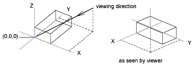

Specify a view point or [Rotate] <display compass and tripod>: Specify a point, enter r, or press Enter to display a compass and axis tripod
- View Point
Creates a vector that defines a direction from which the drawing can be viewed. The view defined is as if the viewer is looking from the point back at the origin (0,0,0).

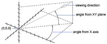

Specifies a new viewing direction using two angles.
- Enter angle in XY plane from X axis.
The first angle is specified with respect to the X axis, in the XY plane.
- Enter angle from XY plane.
The second angle is specified up or down from the XY plane.
