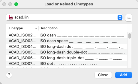

Load or Reload Linetypes Dialog Box
Loads a linetype whose definition exists in a linetype library (LIN) file.
LINETYPE (Command)
Menu: Format > Linetype > .
Summary
The acad.lin file contains the standard linetypes.
List of Options
The following options are displayed.
File Name
Displays the name of the current LIN file. You can enter the name of another LIN file or click the File button to select a file from the Select Linetype File dialog box.
Browse
Displays the Select Linetype File dialog box, in which you can select a different linetype (LIN) file.
Available Linetypes
Displays the linetypes available to load. To select or clear all of the linetypes on the list, right-click and choose Select All or Clear All.
