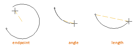

Endpoint of arc
Completes an arc segment. The arc segment is tangent to the previous segment of the polyline.
Angle
Specifies the included angle of the arc segment from the start point.
Entering a positive number creates counterclockwise arc segments. Entering a negative number creates clockwise arc segments.
