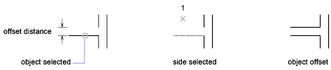

You can offset an object at a specified distance or through a point. After you offset objects, you can trim and extend them as an efficient method to create drawings containing many parallel lines and curves.
The OFFSET command repeats for convenience. To exit the command, press Enter.
The following prompts are displayed.
Offset Distance
Creates an object at a specified distance from an existing object.
