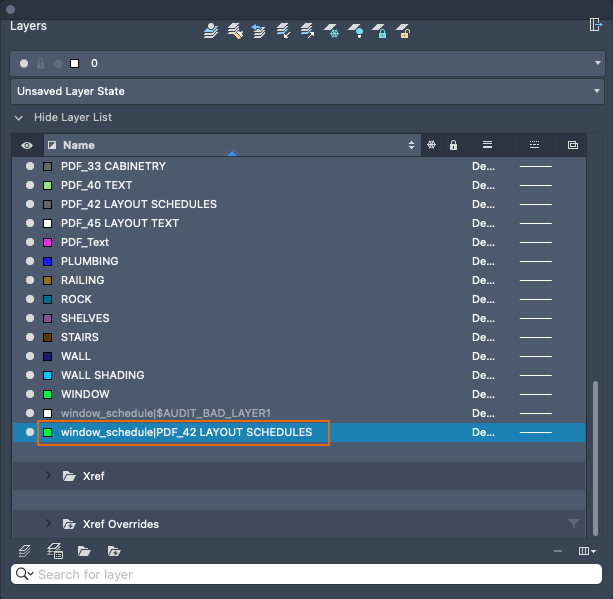

When you attach a drawing file, its layers and layer properties are added to the current drawing. Each layer name is prefixed with the xref's name, which can be different than the referenced drawing's file name.
You can change or override the visibility, color, linetype, and other properties of an xref's layers and define how you want those changes handled when the xref is reloaded.
