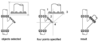

- First and Second source and destination points
When you select two point pairs, you can move, rotate, and scale the selected objects to align with other objects.
The first set of source and destination points defines the base point for the alignment (1, 2). The second set of points defines the angle of rotation (3, 4).
After you enter the second set of points, you are prompted to scale the object. The distance between the first and second destination points (2, 4) is used as the reference length to which the object is scaled. Scaling is available only when you are aligning objects using two point pairs.

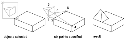

Note: If you use two source and destination points to perform a 3D alignment on non-perpendicular working planes, you get unpredictable results. - First, Second, and Third source and destination points
When you select three point pairs, you can move and rotate the selected objects in 3D to align with other objects.
The selected objects move from the source point (1) to the destination point (2).
The selected object is rotated (1 and 3) so that it aligns with the destination object (2 and 4).
The selected object is then rotated again (3 and 5) so that it aligns with the destination object (4 and 6).
