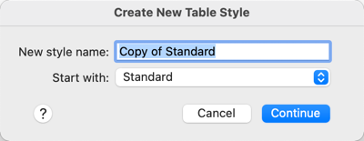

Create New Table Style Dialog Box
Specifies a name for the new table style and specifies the existing table style on which the new table style will be based.
Access Methods
TABLESTYLE (Command)
Tool Sets: Drafting tab > Table panel > Table Style. :
On the Table Style Manager dialog box, click New.
List of Options
The following options are displayed.
New Style Name
Names the new table style.
Start With
Specifies an existing table style whose settings are the default for the new table style.
Continue
Displays the New Table Style dialog box, in which you define the new table style.
