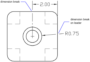

With dimension breaks, you can keep the dimension, extension, or leader lines from appearing as if they are a part of the design.
Dimension breaks can be added to a dimension or a multileader automatically or manually. The method that you choose to place dimension breaks depends on the number of objects that intersect a dimension or multileader.

Automatic Dimension Breaks
To create dimension breaks automatically, you select a dimension or multileader, and then use the Auto option of the DIMBREAK command. Automatic dimension breaks are updated any time the dimension or multileader, or intersecting objects are modified.
