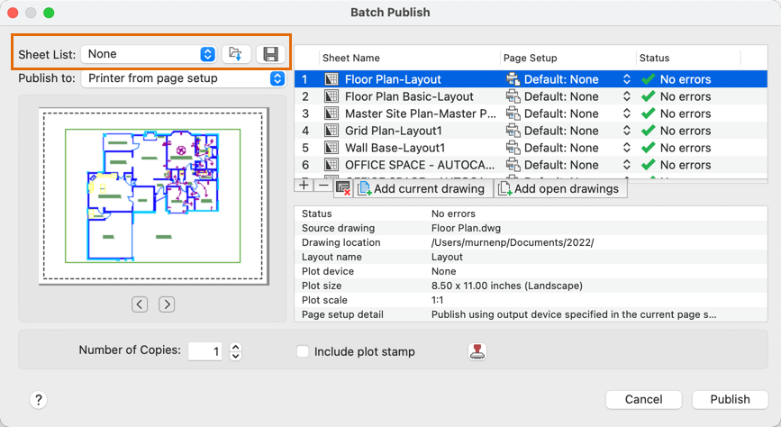

When using the PUBLISH command you can now save the current list of drawings as a DSD file for reuse or load a list of drawings from a saved DSD file.
  • Once you've added your drawings and layouts for publishing, click Save to create the .dsd file that can be reused next time you publish.
  • Once you've created a .dsd file, next time you publish, click Load to select the .dsd file saved previously to restore the list of drawings and layouts to publish.
If you enter +PUBLISH at the Command prompt, you can select an existing Drawing Set Descriptions (DSD) file from a standard file selection dialog box. The Publish dialog box opens and displays the drawing set saved in the DSD file.
