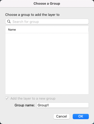

Choose a Group Dialog Box
Adds references of the selected layers to a specified layer group.
LAYERS (Command)
Menu: Format > Layers: Select Layers > Right-Click > Move to Group
List of Options
The following options are displayed.
Choose a Group to Add the Layer To
Lists the layer groups that you can add selected layers to.
Search for Group
Filters the Layer Group list by name as you enter characters.
Layer Group List
Lists all the layer groups in the current drawing or the layer groups that match the characters entered in the Search for Group text box.
Add the Layer to a New Group
Adds the layers selected in the Layers palette to the new layer group.
Group Name
Specifies the name of the new layer group.
