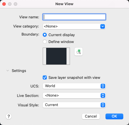

New View Dialog Box
Saves a new, named view from what's displayed in the current viewport, or by defining a rectangular window.
NEWVIEW (Command)
Toolbar:
List of Options
The following options are displayed.
View Name
Specifies the view’s name.
View Category
Specifies a category for the named view.
Boundary
Defines the area of the drawing that is assigned to the named view.
Current Display
Uses the current display as the new view.
Define Window
Uses a window as the new view, which you define in the drawing area by specifying two opposite corners.
Define View Window
Temporarily closes the New View and View Manager dialog boxes so that you can use the pointing device to define the opposite corners of the New View window.
Settings
Provides options for saving settings with the named view.
Save Layer Snapshot with View
Saves the current layer visibility settings with the new named view.
UCS
For model and layout views, specifies a UCS to save with the new view.
Live Section
For model views only, specifies the live section applied when the view is restored.
Visual Style
For model views only, specifies a visual style to save with the view.
