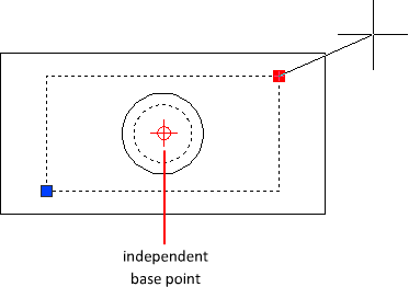

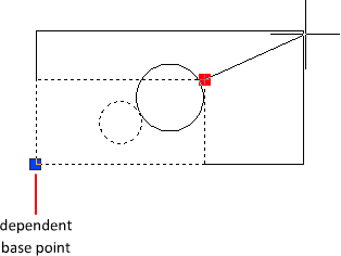

- Base Type
Specifies whether the base point for the action is dependent or independent of the associated parameter’s base point.
- Dependent
Scales or moves selected objects relative to the base point of the associated parameter.
- Independent
Scales or moves selected objects relative to a base point defined separately from that of the associated parameter.

- Base Type
- Specifies whether the base point for the action is dependent or independent.
